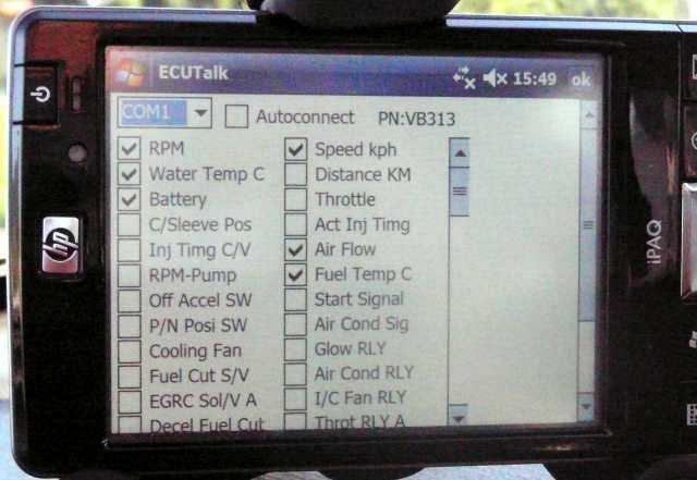

Nissan Consult Interface - diagnostika pre Nissan s tymto konektorom
Misovi sa podarilo rozchodit moj smejd z Taiwanu, a teraz sa hra ... :-D
Podporovane SW: DDLreader v.16c, ConZult, ScanTechNissan, Z-Control, SRTalk v.1.0, CSetup v.2.0, ZTalk v.1.1, Nissan Data Scan v.1.4, Nissan Data Scan v.1.51, a ine

Zatial som nasiel iba jeden SW spolupracujuci s RD28EFI a to http://www.ecutalk.com/. Ostatne sa sice s ECU spoja ale asi nemaju spravne namapovane senzory - nic neukazuju. Ecutalk vie sledovat:
ZD30: Spill Valve, Barometer, Inj Timing CV, RPM-Pump, VNT SV 1
RD28: C/Sleeve Pos, Act Inj Timing, Inj Timing CV, RPM-Pump
TD27: Target F/INJ, C/Sleeve Pos, Act Inj Timing, Inj Timing CV, RPM-Pump
TD42: Barometer, RPM-Needle Lift, IC INT/A Temp, Act Inj Timing, Inj Timing CV
so in terms of most common sensors:
Inj Timing CV - all
Act Inj Timing - all bar ZD30
RPM-Pump - all bar TD42Ti which has RPM-Needle-Lift instead, but this additional RPM is pretty useless.
C/Sleeve - RD28/TD27
Barometer - ZD30/TD42
Spill Valve, VNT SV1 - ZD30 only
RPM-Needle Lift - TD42 only
these are the current readings not supported by diesel:
xx.xL/100KM, INJ% - will leave as-is as in hope eventually we can get some kind of fuel stuff
1) xxºB - timing - replace with actual inj timing -xxº (all bar ZD30), and spill valve(xxCA) or VNT SV1 (xx%T) for ZD30? - isnt much room for anything to explain the reading.
2) AAC: xx - replace with ICV:xx%
3) O2:.xxV - replace with CS:x.xV (RD28/TD27) or Barometer (xxxxhPa) for ZD30/TD42

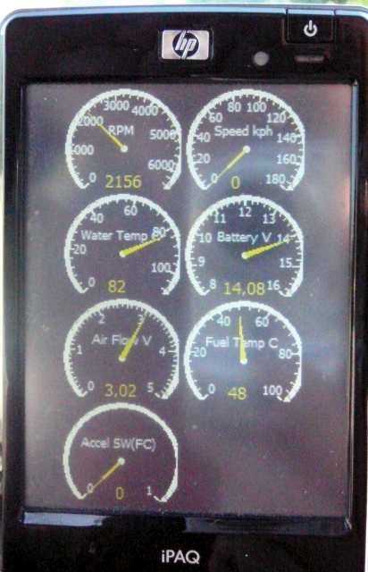

Teraz uz viem ze vahu vzduchu mam OK. :-D
Nasleduje pokus o instalaciu na PDA IPAQ 214.

Uz som nasiel aj ako dobastlit USB Host na Ipaq 214, uz zostava najst iba prevodnik USB / RS232 s cipom FTDI232 a ficime aj na PDA. :D
Patrol GR Y61, 2,8TD
Štv, 26.08.2010, 19:09
Príspevky: 705
Tak to mam rozbehane aj na PDA HP IPAQ214.
